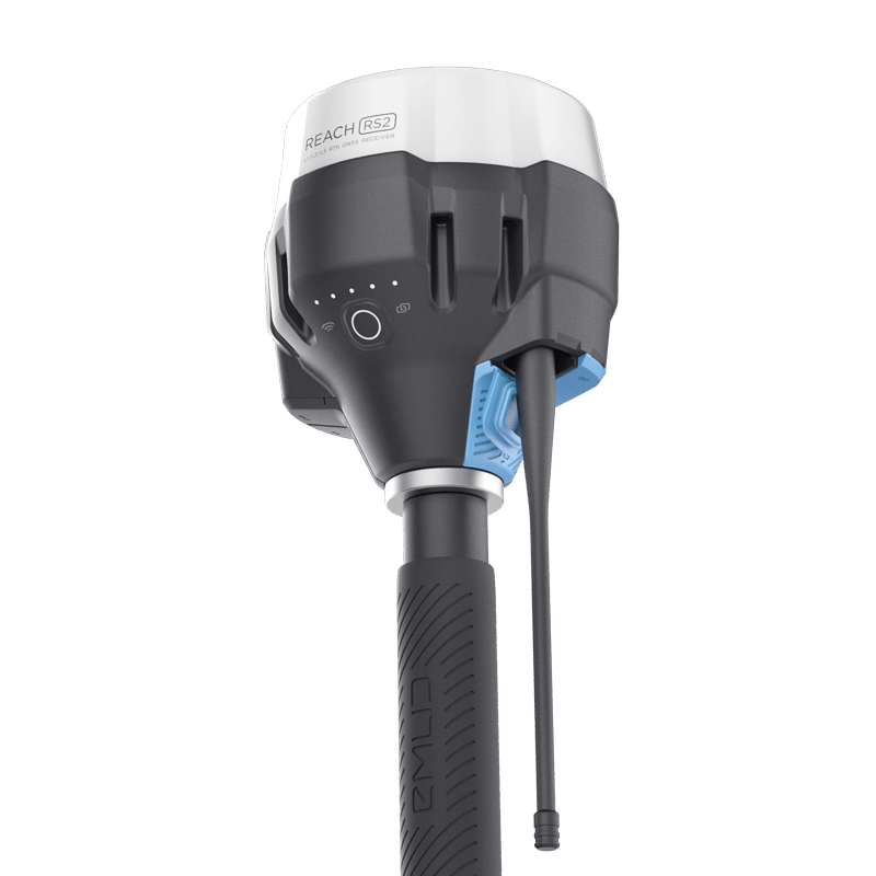

LoRa Radio and Reach RS2
Reach RS2 carries the same LoRa radio, fully compatible with Reach RS/RS+. It is also worth mentioning that the LoRa antenna of RS2 has become more rugged.
Reach RS2 with LoRa antenna

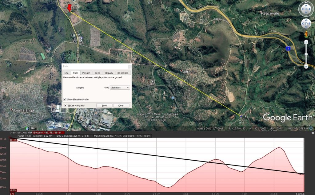

“Real-world” test of LoRa
Luke checked how LoRa performed in the sub-urban area with buildings, mountains, etc. He reported successful data transfer behind the vegetation, buildings, and even a mountain which is over 1 km with no tunnels.
Stable LoRa link and fixed solution at 4.9 km baseline in “real-world” test

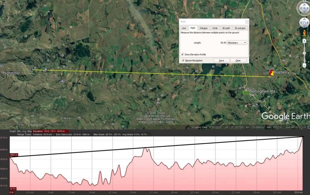

Long range test
Luke also tested the LoRa range at 15 km, 25 km, and 35 km baselines trying to get the most out of the radio link. He chose spots in the KwaZulu-Natal midlands on the top of a hill.
The first 2 fixes at 15 km and 25 km were anticipated as the base was clearly visible. The interesting thing is that when Luke began climbing up the pass into the Highmoor Reserve he could receive data correction straight away from 35 km!
Fix at baseline of 35 km

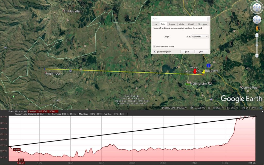

After Luke got a fix at the baseline of 35 km, he decided to push the limit even further. So at the top of the mountain, he reported the fix on a distance of 39.8 km away from the base!
Fix at baseline of almost 40 km

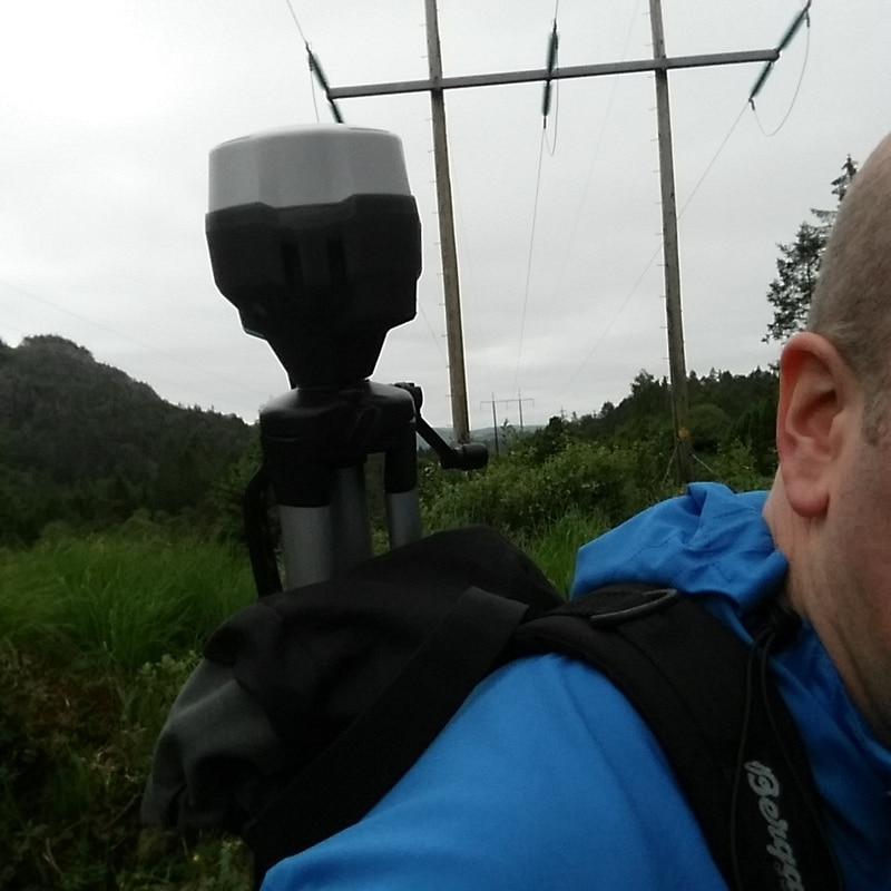

Tore, our pro-user from Norway, conducted another test to check the LoRa range. He installed the base near his house, strapped RS2 rover to his backpack and went out for a hike up the local hill.
There was no direct line of sight between the base and rover, only dense forest and hills. Thus, Tore wanted to see how much data the rover would pick up from the base.
His way led through a dense spruce forest to a clearing with a high-voltage power line above. In such conditions, interference from power lines may affect GNSS and radio performance. This may cause initialization issues and position drift. Nevertheless, Tore received a fixed solution located directly beneath power lines, and at a distance of 4.2 km from the base station.
Tore with RS2 in his backpack beneath power lines
Corrections received without direct line of sight, baseline 4.2 km

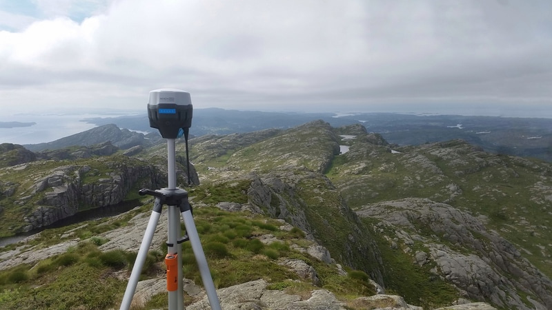

Further, on top of the mountain, with no line of sight and a huge mountain in between, RS2 rover still picked up the data from the base.
Reach RS2 receives corrections on top of the mountain
“Huge buildings, mountains will still block LoRa but dense forest and hilly terrain (depends on the situation) isn’t enough to put the LoRa out of the game. It really penetrates well in such conditions.”
