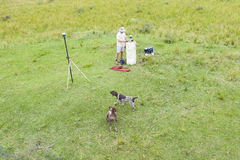

Luke Wijnberg of 3DroneMapping is one of our pro-users who recently ran some accuracy tests of Reach RS2. Luke collected seven points with the RS2 rover acquiring live corrections from the Reach RS2 base placed over survey monument. When the positions were measured, he captured the same points using local VRS corrections service using Reach RS2 rover.

Luke Wijnberg tests Reach RS2
Luke is placing Reach RS2 base on survey monument
