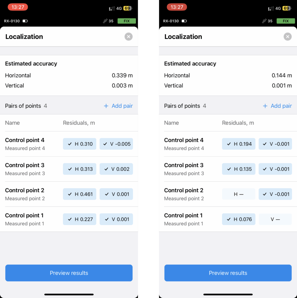

After adding pairs of known and measured points and a series of mathematical calculations, you get the residuals. These are horizontal and vertical “errors” for each pair of points that allow you to assess the accuracy of the resulting localization. In Emlid Flow, you can easily turn on and off horizontal and vertical point coordinates, or remove the ones that obviously stand out from the rest to achieve the desired accuracy. All these things can be done on a single screen, so you can watch the estimated accuracy changes in real time.
Residuals in Emlid Flow
Residuals turned on and off
