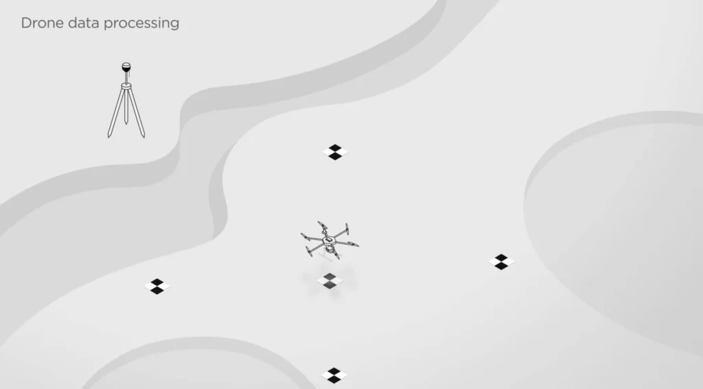

UAV mapping and orthomosaics
PPK is ideal for large-area drone surveys—especially on remote or large sites where maintaining an RTK link is impractical.
The workflow:
  • Place a base station on known coordinates at the site.
  • Fly your drone with a module or with onboard camera time marks
  • Both base and drone log raw GNSS throughout the flight.
  • Camera records event marks via hot shoe (or timestamp log) at each photo trigger.
  • Post-process the base and rover logs in Emlid Studio.
  • Output: precise geotags for every image.
Feed these georeferenced photos into Pix4D, Agisoft, DroneDeploy, or other photogrammetry software for centimeter-accurate orthomosaics. No ground control points needed—just a known base location.

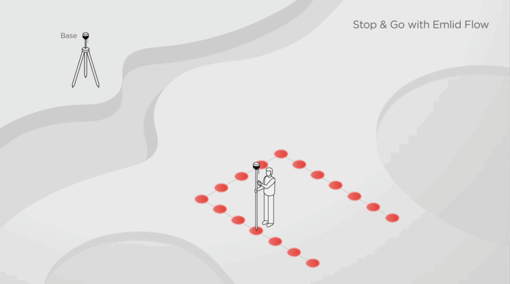

Stop & Go surveying
Position your rover at specific locations (GCP marks, building corners, utility poles, cadastral points) and pause for 10–60 seconds to collect data. Move to the next point. Repeat across your survey area.
Stop & Go surveying
This workflow balances speed and accuracy. You capture discrete survey-grade points without logging a continuous track. Perfect for:

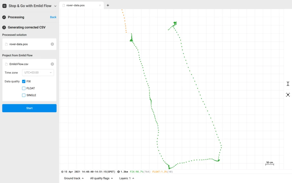

Processing PPK data in Emlid Studio
After collecting base and rover logs in the field:
  • Export results: coordinates, geotags, or continuous track.
  • Import both RINEX files into Emlid Studio.
  • Trim logs to the overlapping time period (if needed).
  • Review data quality: satellite count, signal strength, multipath indicators.
  • Configure processing: select GNSS constellations, antenna type, reference frame.
  • Run processing and review the solution (fixed ambiguities = best accuracy).
data processing surveying software
Data processing in Emlid Studio surveying software
Emlid Studio is free and runs on Windows, macOS, and Linux. Processing is deterministic—you can reprocess with different settings anytime to optimize accuracy or audit your results.
