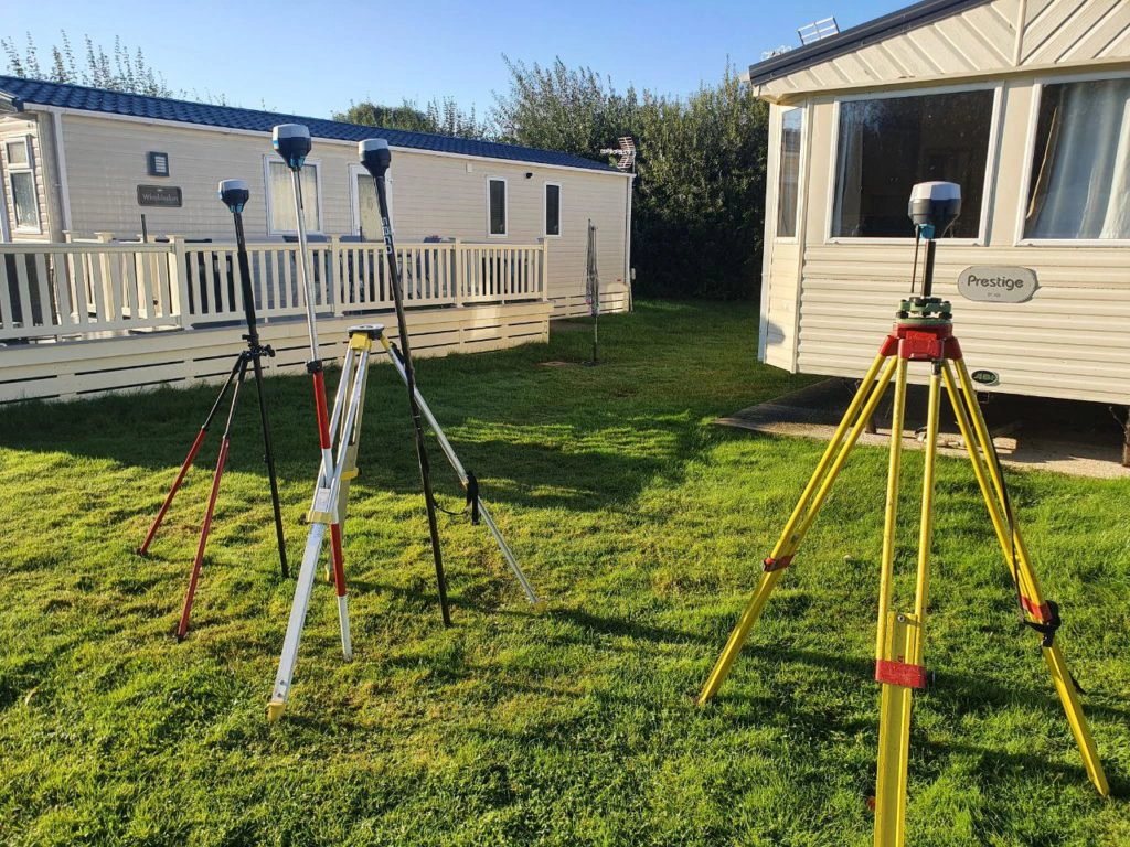

Before the start of the big topographic survey

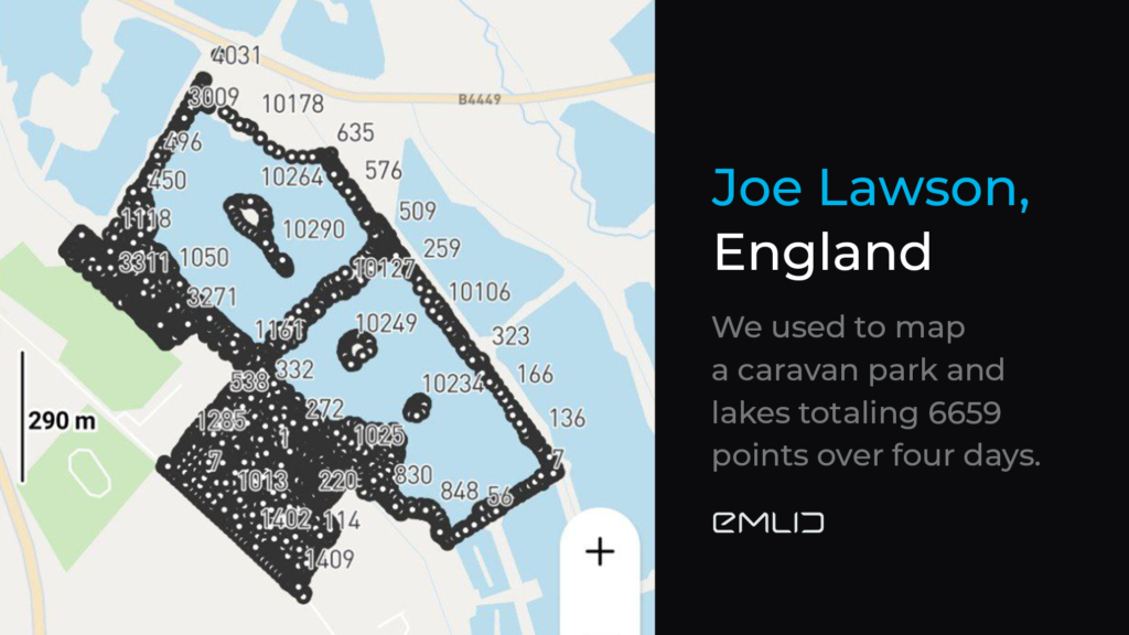

—More than six thousand points in your last project. That’s impressive! Could you tell us a bit more about this?
—On the first day, we set up control using a total station to put in fixed points to check back with the rovers each day. The base position was logged for 6 hours and post-processed against a local CORS. After that, we used to map the park totaling 6659 points over four days. All coding was done in ReachView 3.

Three Reach RS2 units as rovers and one as a base
—Have you faced any difficulties?
—We did lose the LORA signal as we moved further from the base, but I fixed this by recording a point with my rover for 5 minutes. Then I moved the base to the new location and updated its position by reading its geographic coordinates from the point recorded with the rover in the ReachView 3 app. It was so easy and worked perfectly! We checked all three rovers against the fixed points after the base move, and all three were within the 15mm again.

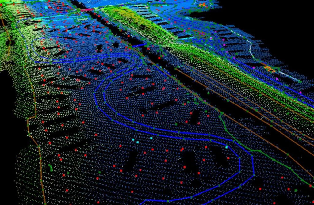

—Once all the data had been recorded, I performed a visual check by overlaying the points on top of our national LIDAR data set for the area. And they were all in the right place. As the coding had been done onsite, minimal drawing was required as the codes do the linework for you (we use a program called LSS).
Interview with Emlid User - JL/3
Points overlaid the LIDAR data set for the area
