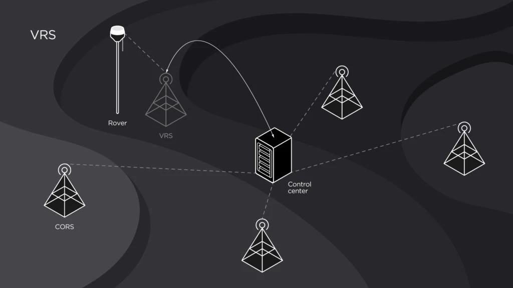

What Is VRS
If you’re working with NTRIP, there’s a good chance you’ll come across this term. VRS or Virtual Reference Station is a useful tool for long baselines.
The density of NTRIP bases and CORS can vary greatly from place to place. If the density of stations is enough, but you are too far from any of them, VRS helps you eliminate your baseline.
Say, you are 70 km away from the nearest station. When working in RTK mode, this baseline is quite long. To create a VRS, your rover sends data back to the NTRIP caster. NTRIP allows the uniting of the data from your rover and the data from dense NTRIP bases and models a virtual base next to you. Thus, your baseline will go from 70 km to 0 km.
The elimination of a baseline helps establish a fixed solution faster and keep it stable. VRS is especially useful for Reach RS+.
VRS allows you to eliminate the long baseline issue
