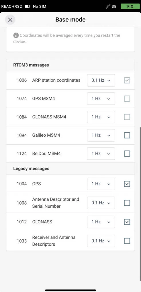

This update allows the connection of a Reach RS2 as a base station with traditional third-party receivers and agricultural equipment. You now have this option with RTCM3 legacy messages 1004, 1008, 1012, 1033 for multi-band devices.
RTCM3 legacy messages in a Base mode in ReachView 3
To set up various RTCM messages, go to the Base mode in the ReachView 3 app, choose your type of legacy messages and the required rate.

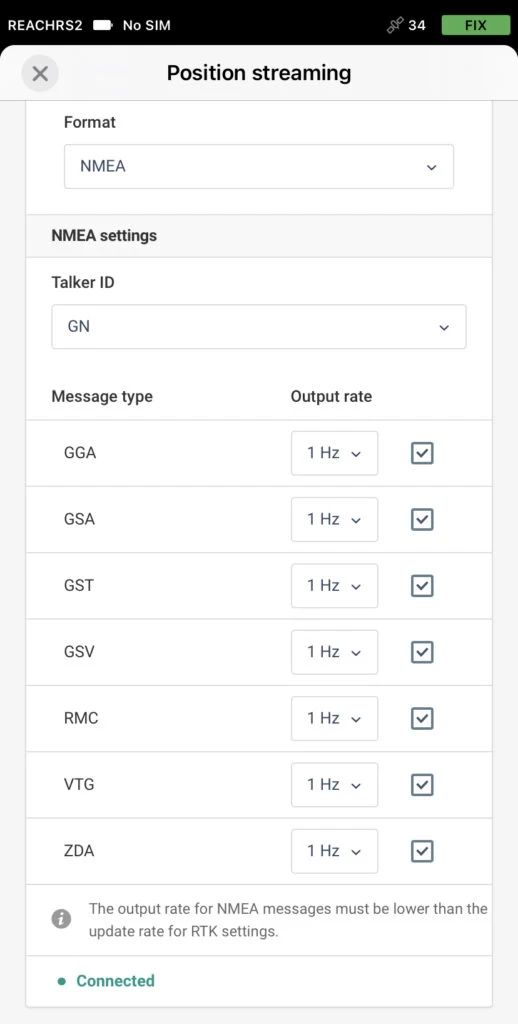

With this release, we have also added configurable NMEA position output in Reach Panel. You can choose a Talker ID and the desired set of NMEA messages.

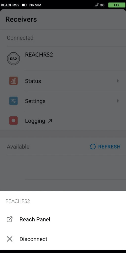

To access Reach Panel from the ReachView 3 app, go to the Receivers screen, tap the receiver’s name, and choose Reach Panel. The app will navigate you to the Reach Panel.
Access to Reach Panel from ReachView 3
In the Reach Panel, open the Position Output tab, select the NMEA format, and then set up a Talker ID, the required messages, and their frequency. Keep in mind that the NMEA output rate should be equal to or lower than the RTK Settings rate.
NMEA output configuration in Reach Panel
Specifying the talker ID and the message parameters helps you connect Reach rovers to various GIS apps, software for GPR, and agriculture machinery guidance. This means that you can freely use Reach with software and hardware requiring a specific NMEA output.

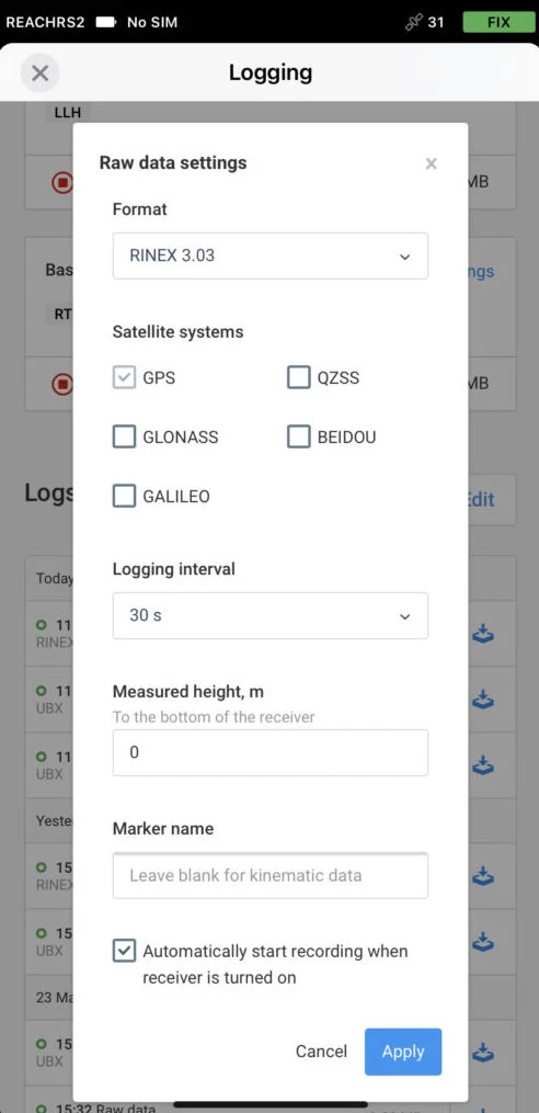

We have also added configurable RINEX logging in ReachView 3, which allows you to filter out some satellite systems (e.g., record GPS only while in GNSS all systems are enabled), log RINEX at a lower rate than GNSS rate, and enter the antenna height.
One more handy feature is logging autostart. It lets you log automatically after rebooting or turning on the device.
Raw data settings in ReachView 3
