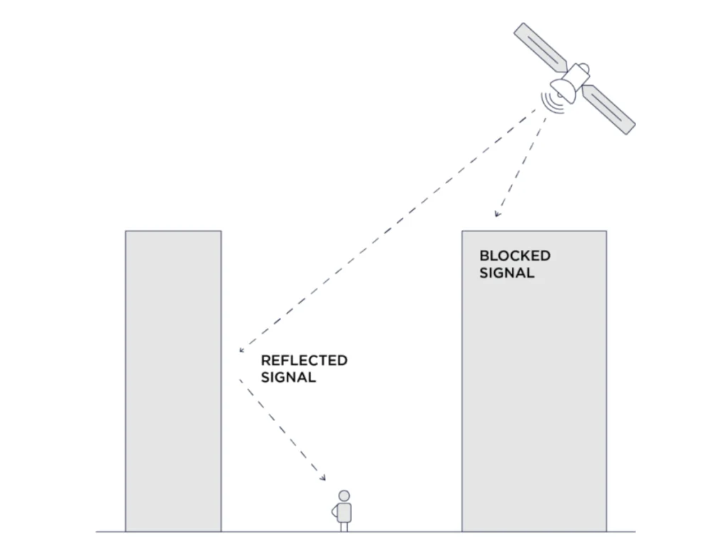

Multipath errors happen when GNSS signals reflect off surfaces such as buildings, vehicles, water, or even the ground before reaching the receiver. These reflections lead to skewed positioning data, particularly in urban or built-up environments, significantly degrading GNSS accuracy.
This is one of the most common limitations of GPS, especially when operating near reflective surfaces.
How to deal with multipath?
The best way to overcome these errors is to avoid placing your base near significant metal structures and elevating your receiver as high as possible off the ground. It is also helpful to use a good antenna with a built-in ground plane that can block low-angle reflected signals from the ground. The Emlid Reach receivers come with this type of antenna.
Disadvantages of GPS, like signal reflection, are inevitable, but manageable with proper setup and gear.

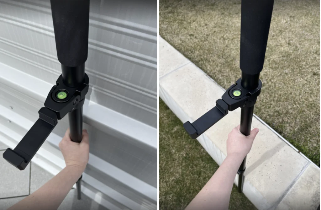

When the level bubble comes out of plumb, it can significantly impact the accuracy of your GNSS surveying measurements. There are many reasons for this, including vibrational shocks and the warming and cooling of the environment, which causes the metal components to expand and contract. It is recommended that periodic in-office checks be done.
How to calibrate the level bubble?
If you’re in the field and want to check it, you can find a vertical structure like a building’s wall to see if your level bubble is out of plumb.
  1. Remove the receiver from the pole and place it two inches from the structure, making sure it is parallel to the structure.
  2. Then rotate the pole 180 degrees and check the bubble; if it is not centered, it is out of plumb.
While it’s best practice to calibrate the pole, there is a workaround that allows you to still make accurate measurements with the bubble out of plumb. Just follow this procedure:
  1. Measure for 60 seconds, then rotate the pole 180 degrees and take another 60-second measurement.
  2. Then, average these two shots to remove the error. There are many different ways to check and calibrate the bubble.
YouTube has many reference materials to help you here. Also, with modern Reach receivers, you can enable tilt compensation, which allows you to collect accurate measurements even with a tilted pole.

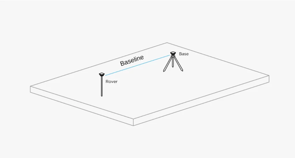

The baseline is the distance and direction between the base station and the rover. As this distance increases, the accuracy of the measured readings will degrade. This is a classic GNSS issue, and it happens because the base station and rover are located far enough away to experience different atmospheric and ionospheric conditions.
baseline
Baseline between base and rover
Environmental conditions can distort GNSS signals. If both receivers are affected similarly, the errors tend to cancel out. This assumption is built into positioning algorithms, allowing us to effectively exclude these common errors from the calculations.
However, if the signal distortions differ between the receivers, these errors cannot cancel out, leading to positioning inaccuracies. While centimeter-level accuracy is achievable even at distances of up to 60 km in RTK and 100 km in PPK, for optimal results, keeping the baseline as short as possible is recommended. The RTK error model—7 mm + 1 ppm—illustrates how accuracy decreases with distance.
How to avoid a long baseline?
One way to overcome this challenge is not to rely on CORS but to set up a local base station on your site. The Emlid Reach receivers can act as a rover and a reliable base station.
Another option is Emlid Corrections, a built-in service available directly in Emlid Flow. Instead of connecting you to one fixed reference station that might sit many kilometers away, it uses a VRS (virtual reference station) approach: the network takes data from a grid of real reference stations spaced under 40 km apart and computes a virtual base at your exact location.
Your rover is effectively measuring against a base right where you’re standing, not one kilometers down the road, so you avoid the baseline-related accuracy drop-off this section describes, and there’s no local base to set up on-site.

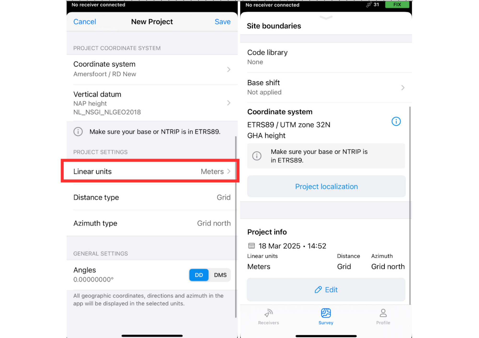

Projected coordinate systems use linear measurement units, typically meters or feet. A common mistake is selecting a coordinate system that uses meters when your project requires feet. This mismatch can prevent your data from aligning correctly with previous survey work.
How to know which linear unit to choose?
Using a site like epsg.io, you can investigate further by querying for your desired projection and looking into the metadata to see which linear unit is used.
Emlid Flow offers a dedicated setting that lets you choose the appropriate unit of measurement for your project:
Settings for the appropriate unit of measurement in Emlid Flow
We recommend double-checking the selected units, even if the coordinate system name includes “ftUS.” The good news is that if you choose the wrong unit and only realize it in the field, you can still adjust it using the same setting in Emlid Flow.

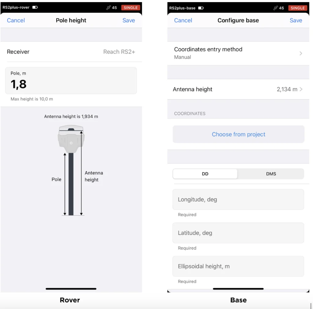

Miscalculated height of the device
Challenge
When entering the receiver’s height, it is easy to measure the wrong span, as different manufacturers require measurements from other places on the instrument. Check with your receiver manufacturer to see precisely what span they want you to measure. The antenna height is usually different from the receiver’s height. And different poles have different scales.
This is one of the more frustrating GNSS issues, and a key limitation of GPS workflows when not followed correctly.
What height do I need to enter when surveying with Emlid Reach?
With Emlid products, for example, you only need to input the distance from the base point to the bottom of the receiver. The distance from the bottom of the receiver to the antenna height is calculated within the software.
Learn more about how to set the antenna height for the RTK in our guide.
antenna height in Emlid Flow
Setting antenna height for the rover and base in Emlid Flow

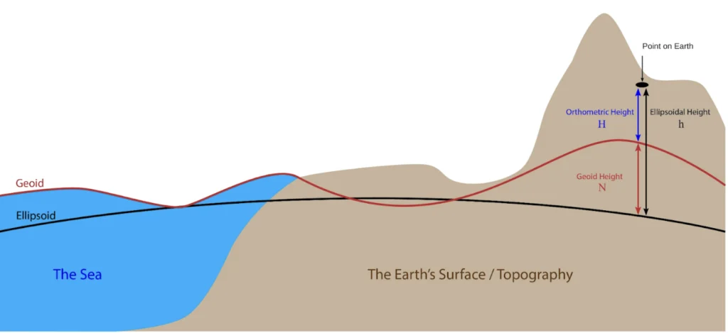

If you’re unfamiliar with elevation reference or vertical datums, you might make mistakes that affect the accuracy of your measurements.
GNSS receivers measure height above the ellipsoid, a smooth mathematical model of Earth’s shape, like a slightly squished basketball. However, this doesn’t reflect real-world terrain or gravity variations.
orthometric height and ellipsoidal height
The difference between orthometric and ellipsoidal heights
How to deal with ellipsoid and orthometric heights?

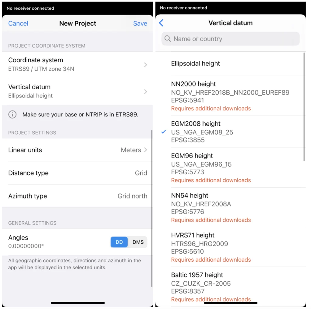

We need orthometric height for practical use—the elevation seen on road signs at mountain passes. Since GNSS gives height over the ellipsoid, we assign a geoid to get orthometric height. It represents sea level and accounts for terrain variations. Choose the correct geoid for the project to get accurate measurements. In the Emlid Flow app, you can simply select the appropriate geoid from the list.
In the U.S., surveyors often use NAVD88 with GEOID12B to obtain precise elevation data. Different regions worldwide have different vertical datums and associated geoids that are most appropriate for getting the best vertical elevation measurements.
Vertical datums in Emlid Flow
Choosing vertical datums in Emlid Flow
