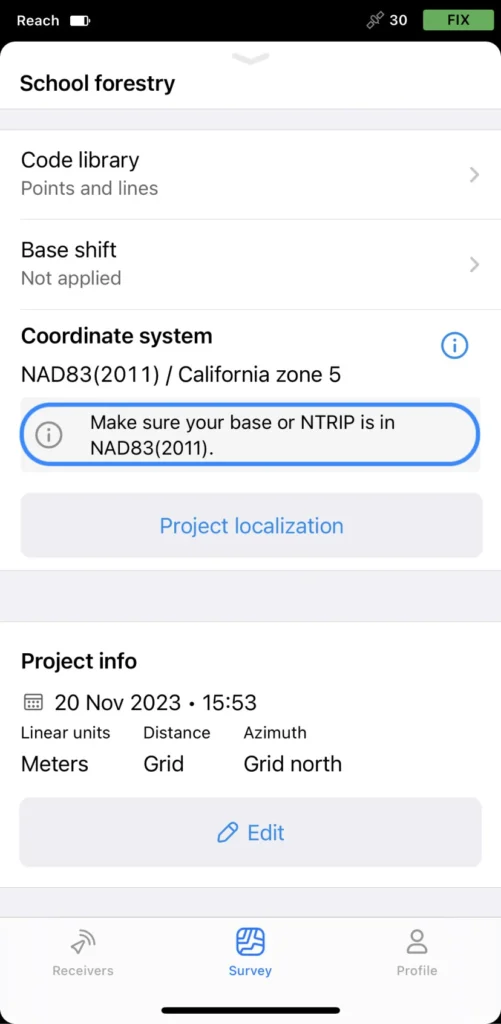

coordinate system
Coordinate system and vertical datum in Emlid Flow
In Emlid Flow, you can double-check your setup after configuring the coordinate system in the project. A notification will appear indicating the required horizontal datum for the base—make sure this datum is also specified in your technical assignment, official project documentation, or the EPSG registry.
Correct CS configuration ensures your GNSS base station broadcasts corrections aligned to the same datum used by your deliverables.
Emlid Flow coordinate system
Coordinate system double-check in Emlid Flow
Check out our blog post to learn more about coordinate systems, their components, and setup.
