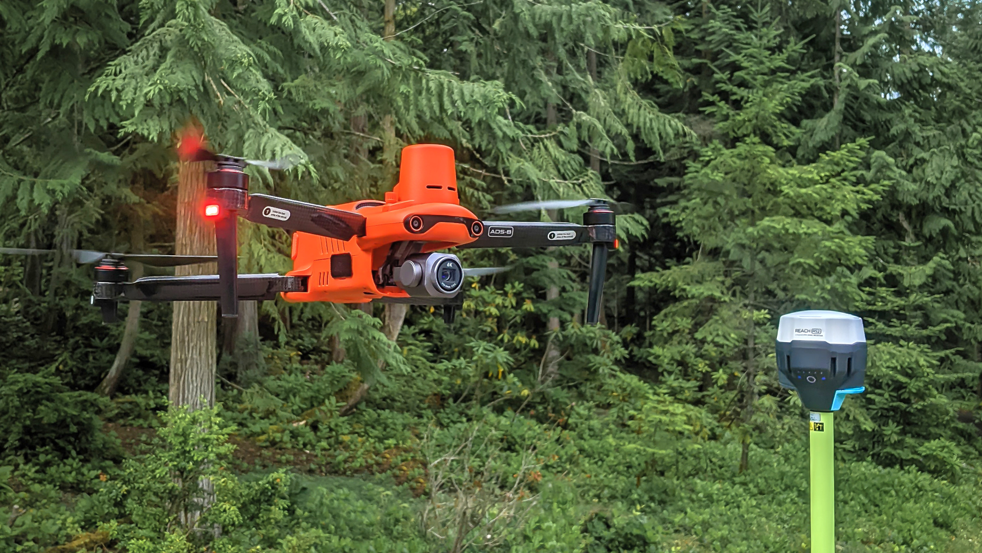

When comparing PPK and RTK survey techniques, both methods can provide highly accurate results if implemented correctly. The main factors affecting accuracy are the quality of the correction data and the equipment used. Emlid Reach receivers provide high-quality correction data to improve the accuracy of PPK drone surveys as well as RTK surveys anywhere in the world.
Reach as a base for Autel Evo II Enterprise
