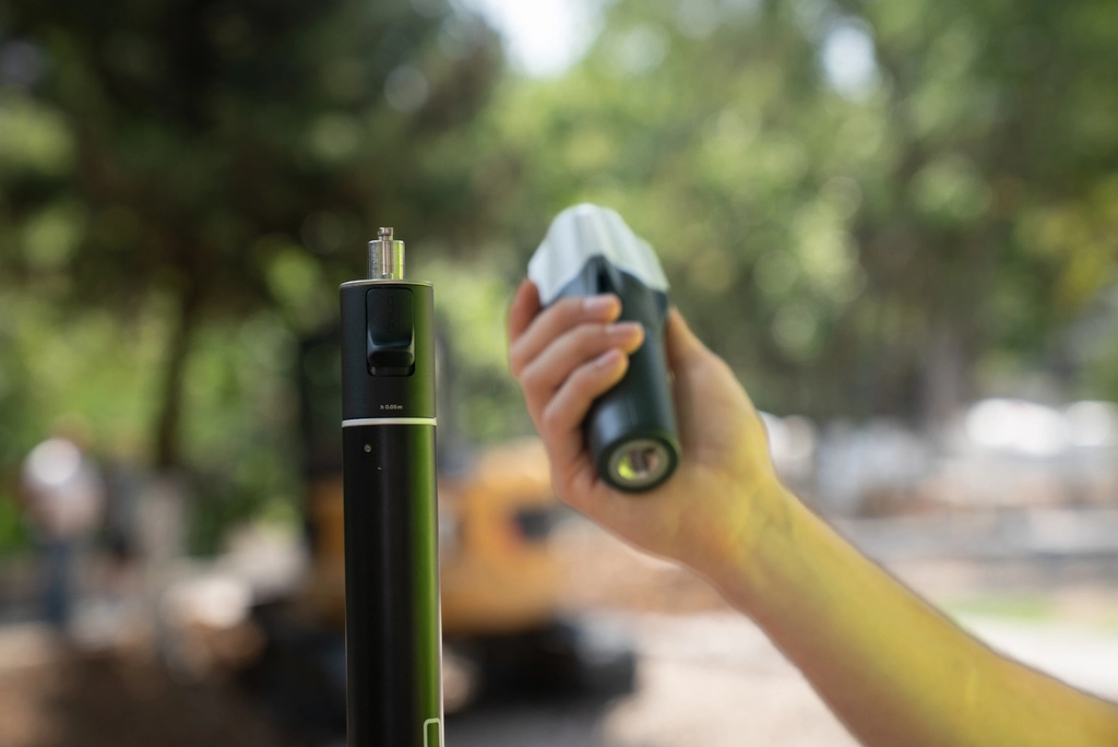

The Reach RX2 was built to work at the speed of your projects. It’s preconfigured and ready to go from the moment it’s powered on. Teams just connect to a CORS or NTRIP service, get a fix, and start collecting data, no complicated setup or training sessions required. This simplicity is a key reason many teams now equip field workers and supervisors, not just surveyors, with the RX2 units.
What makes the RX2 especially effective is its any-angle tilt compensation. It allows crews to take accurate measurements times faster, even when the pole can’t be perfectly vertical, like near walls, in tight corners, or under overhangs. Just get an RTK fix, rotate the pole slightly, and start measuring. The tilt engine is factory-calibrated and immune to interference from nearby metal objects like vehicles or rebar.

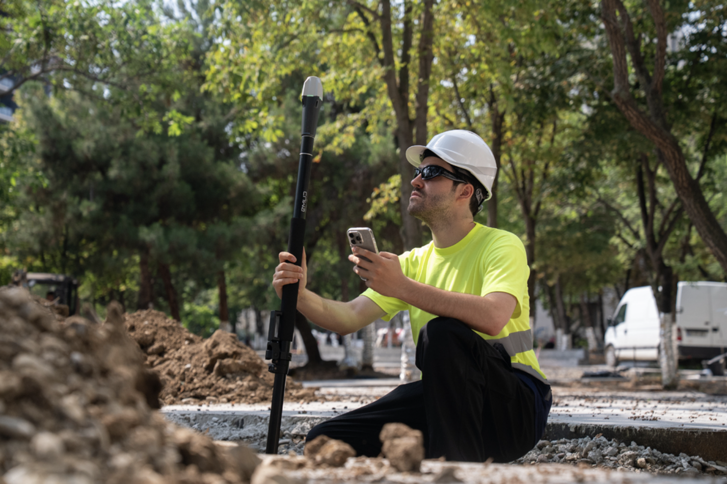

“Now users can stick the pole, stay on the top of the trench, and still get precise measurements.”
— Andreas Larsen, RTK Connect, Denmark.
