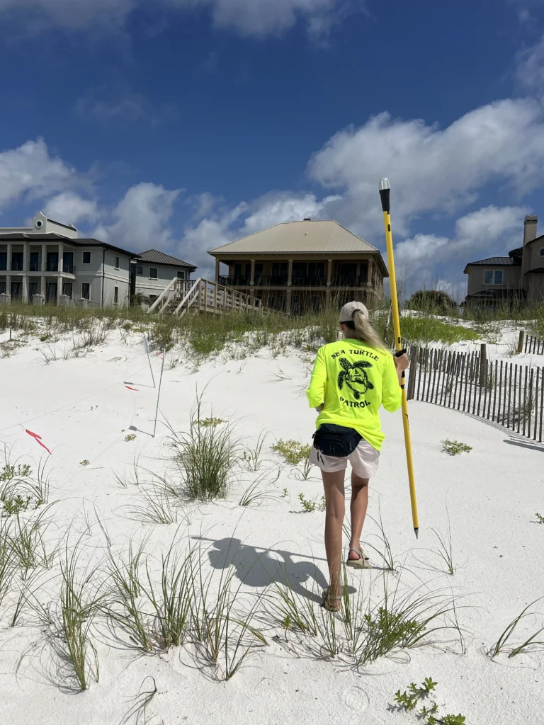

Now, using GNSS and GIS solutions, Kindall’s team can get 1-foot-accuracy data. This solution enables the reliable pinpointing of nests and streamlines the workflows.
When volunteers see turtle activity on the beach, they log the information in the Survey123 app. This alerts Kindall’s team to the rough location of the nest.

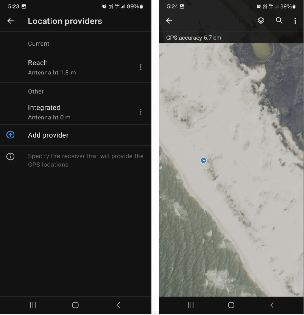

They validate the presence of nesting activity and then capture the coordinates with the Emlid Reach RS2+ or Reach RX receiver and ArcGIS Field Maps. To achieve high-accuracy data, the Reach receivers are connected to an NTRIP service to get RTK (real-time kinematic) GNSS corrections.
The receivers can then be connected to ArcGIS on an iPhone, which is used as a data collector.  The Reach RX can be connected with ArcGIS Field Map via Bluetooth, while the Reach RS2+ connects over the TCP server.
ArcGIS Field Maps and Reach GNSS receiver
ArcGIS Field Maps connected to the Reach receiver

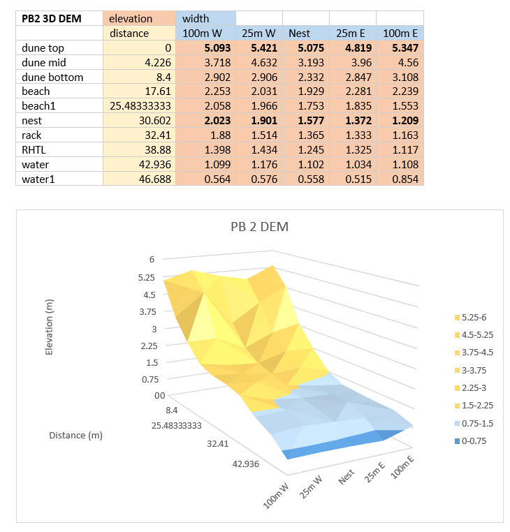

The precise location data feeds directly into the team’s nesting site suitability analysis using ArcGIS Pro. They measure elevation points from the nest location along a line from the dune crest to the waterline. They then compare these elevation profiles to adjacent beach sample profiles without nests, first 25 meters away and then 100 meters away.
“If we find that turtles only nest at certain elevations, we can advocate for policies to maintain those elevations and create protected zones,” Kindall explained.
ArcGIS Pro visualization
Nest elevation profiles and beach samples visualized in ArcGIS Pro using data from Emlid Reach GNSS receivers

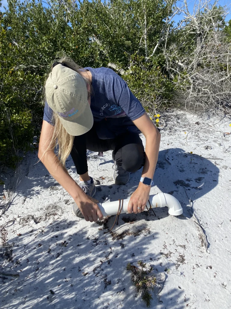

It is thought that the beach mouse has a preferred elevation where they most comfortably burrows, but until now, it was untested. Kindall’s team monitors beach mouse presence at different elevations using track tubes.
These track tubes are PVC pipes with card stock and an ink pad inside. The tubes are placed 300 meters apart. They bait the far end of the tube and look for inked-feet tracks on the cardstock.
Environmental monitoring
Kindall is opening a track tube to check for beach mouse activity
Staff check the tubes every other month and complete a form within the ArcGIS Survey123 app, asking for the presence/absence of beach mouse activity. If there is a deviation from the normal activity at a track tube site, an ArcGIS Pro map will alert the team to that location.
