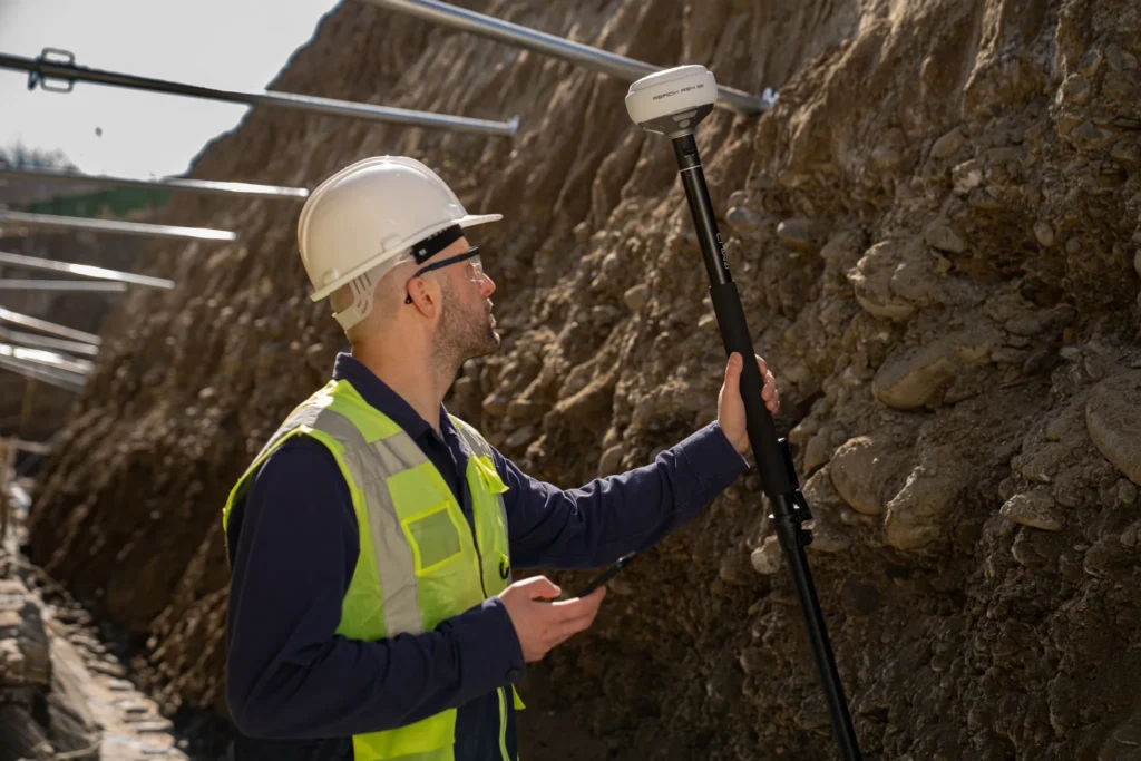

Construction surveyor in a safety vest and hard hat using a GNSS receiver to measure an exposed utility trench before backfill. The image fits the article’s focus on capturing accurate as-built field data before the trench is closed.
Surveyor measuring an exposed utility trench with a GNSS receiver during an as-built survey

Late capture is harder to avoid when invert and trench-edge points require the crew to work at an angle, since standing directly over an open trench isn’t practical. IMU tilt compensation holds accuracy through that tilt: at 30°, the RS4 Pro still delivers 18 mm precision, without recalibration during the job.
