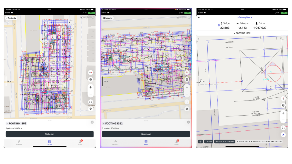

  3. Use Emlid Flow to match tagged ground points with design data.
  4. Conduct construction grade checking before excavation begins.

Images of construction projects on Emlid Flow
The Emlid Flow app is used to ensure design data aligns with ground control.

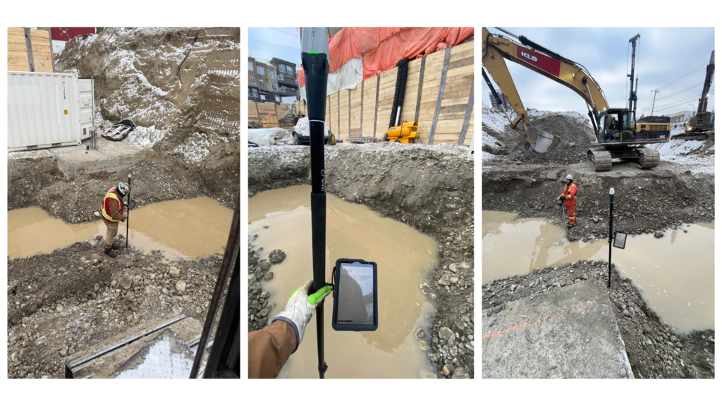

Urban challenges: high-stakes grading at the Sentinel Project
Another project where KLS successfully used Emlid’s receivers was the Sentinel development in downtown Calgary. The project involved building a five-story structure with a deep basement excavation.
Before foundation work could begin, crews installed piling around the perimeter of the site to create a shoring wall.
Footings were then excavated and filled with concrete to support the structure above. The site presented additional challenges because it sits on an old riverbed. Soil conditions were unstable, which made careful excavation and piling installation essential for maintaining structural stability.
During this project, the field teams used Reach RX receivers in multiple workflows:
  • Confirming excavation depths.
  • Verifying grades during foundation preparation.
  • Maintaining alignment during piling installation.
Accurate positioning was especially important because the project was located in a dense urban environment where available working space was limited.
