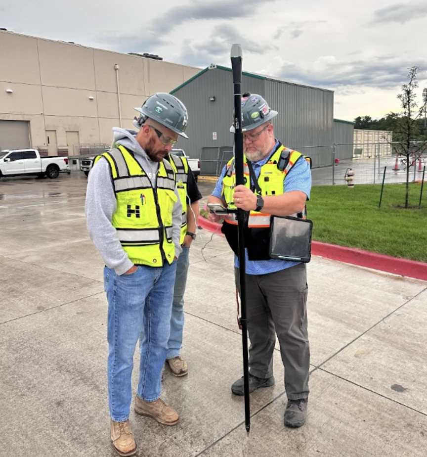

In the field: a dozen superintendents, running verification on their own
Deploying any RTK workflow for the first time means working through some setup nuances, since RTK itself is a precise technology, and getting it right on a real job site takes a few runs to dial in.
For Derek, that process was hands-on: Emlid’s support team walked him through a key step in person, on the same landscaping job site where the search for a solution had started.
Two construction professionals wearing hard hats and high-visibility safety vests stand outdoors beside an industrial building. One man holds a surveying pole and measurement equipment while the other looks on. The scene includes a concrete driveway, parked trucks, a grassy area, and overcast skies.

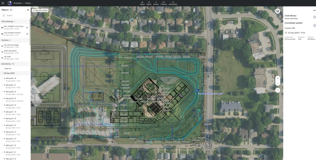

Superintendents access the receiver through Emlid Flow, Emlid’s app for GNSS survey work. It runs on your mobile device (iOS or Android) in the field for point collection and stakeout, and syncs with Emlid Flow 360 in the office so the same project data is available on both ends.
Aerial site plan overlaid on an aerial photograph showing buildings, athletic fields, parking areas, roads, sidewalks, property boundaries, and detailed turquoise topographic contour lines.
Emlid Flow 360
With the Pro plan active, each superintendent has an individual login instead of one shared set of credentials passed around the team. This allows for individual tracking and accountability being able to identify who staked out or collected certain points or features.

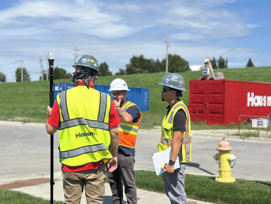

Three construction professionals in hard hats and high-visibility vests stand on a job site, discussing surveying work. One holds a surveying pole, while another carries plans. Construction containers, a fire hydrant, and grassy areas are visible in the background.
Real-time verification keeps projects moving, from field checks and elevation data to faster site preparation before construction begins
