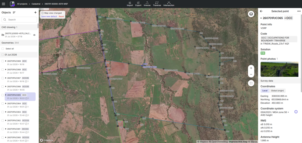

With Emlid Flow 360, a point a field surveyor logs shows up in the office in real time, tagged with the fix type, tolerances, photo, and how long the shot took.

As Chris describes it, on a job where only two of the boundary marks in the field were found, the field surveyor can ask a colleague back in the office to download the pickup points, rework the boundary adjustment, and pushed the new calculation straight to the surveyor’s controller. No trip back to the office required.
On another job, three hours from the office, long grass had swallowed a culvert a surveyor needed to find. Chris recalls being in the office that day when a colleague, watching the surveyor’s real time position update on screen, talked him through finding it.
“From a supervision point of view, when the guys are taking a point out in the field, the surveyors back in the office can see that point turn up almost straight away on Flow 360 and be confident that field surveyors are on the right track“.

“Whether it’s a cadastral job where you’re trying to define boundaries—and the boundary fix might not always be perfect—if field surveyors take a shot with a photo, then the photo and metadata pops up straight away when office surveyors query the point. This helps the supervising surveyor to make sure that the technician in the field is on the right track.“, he adds.

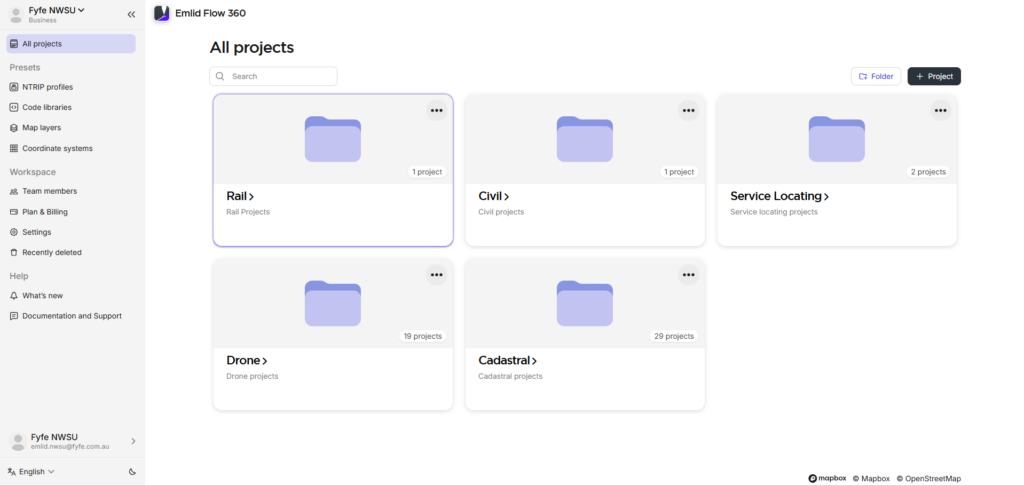

The same folder structure scales the supervision model across the team. Every Fyfe surveyor working on Emlid receivers logs into a single Business account, with shared NTRIP profiles and shared code libraries across the team.

Before, spare units moved between crews on an ad hoc basis, with someone driving in from another site to drop off a receiver so a job could go ahead. With 10 units now in circulation across NSW, that back-and-forth has mostly disappeared, and a crew can pick up what it needs for the next day without interrupting anyone else’s schedule.
“The Emlid workflow is very well structured,” Chris says.
“The fact that anyone who’s linked as a team member can see all the projects within the folder structure, has access to all the NTRIP profiles, and be running off the same code libraries—it helps standardize what we’re doing. Essentially, it has everyone singing from the same hymn sheet for each job.”
