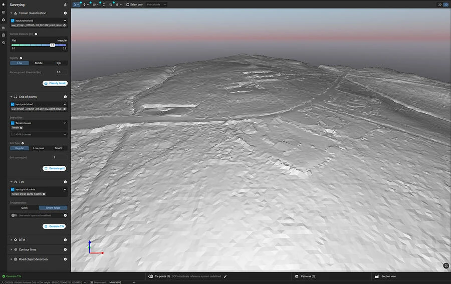

Creating a surface
Survey the existing terrain by collecting all objects on the site to prepare the design surface, then export it in LandXML format. As mentioned earlier, you can take advantage of the Reach RX2 and PIX4D scanning kit to create the terrain surface.
3D terrain surface model generated from drone survey data, showing a triangulated digital terrain model (TIN) with visible excavation features, embankments, and access tracks in a photogrammetry software interface.
Creating a terrain surface in PIX4Dmatic from a point cloud captured with Reach RX2 and PIX4D

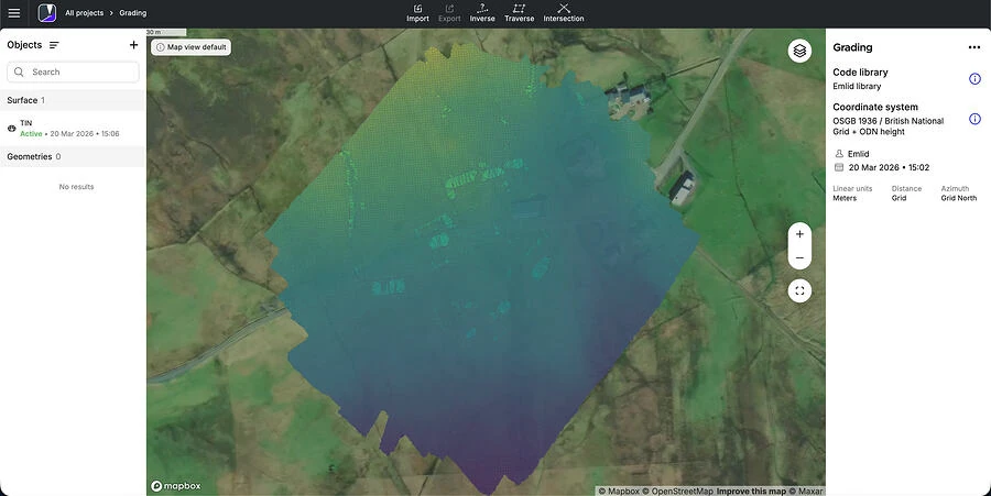

Preparing a project
In the office, sign in to Emlid Flow 360 with your Emlid account and set up the project:
  1. Create a new project in your workspace.
  2. Select the required coordinate system from the coordinate system library or import the localization parameters.
  3. Create and apply a code library with attributes, if needed.
  4. Import geometries in CSV, SHP, KML, or DXF format, if needed.
  5. Add map layers, if needed.
  6. Import the design surface.
Top-down map view displaying a digital terrain model (TIN) overlaid on satellite imagery, representing drone survey data for a rural site with grading and elevation analysis in surveying software.
Terrain surface imported into the project in Emlid Flow 360
Now you can invite field engineers to the workspace so they can access the project and start working with the surface.
